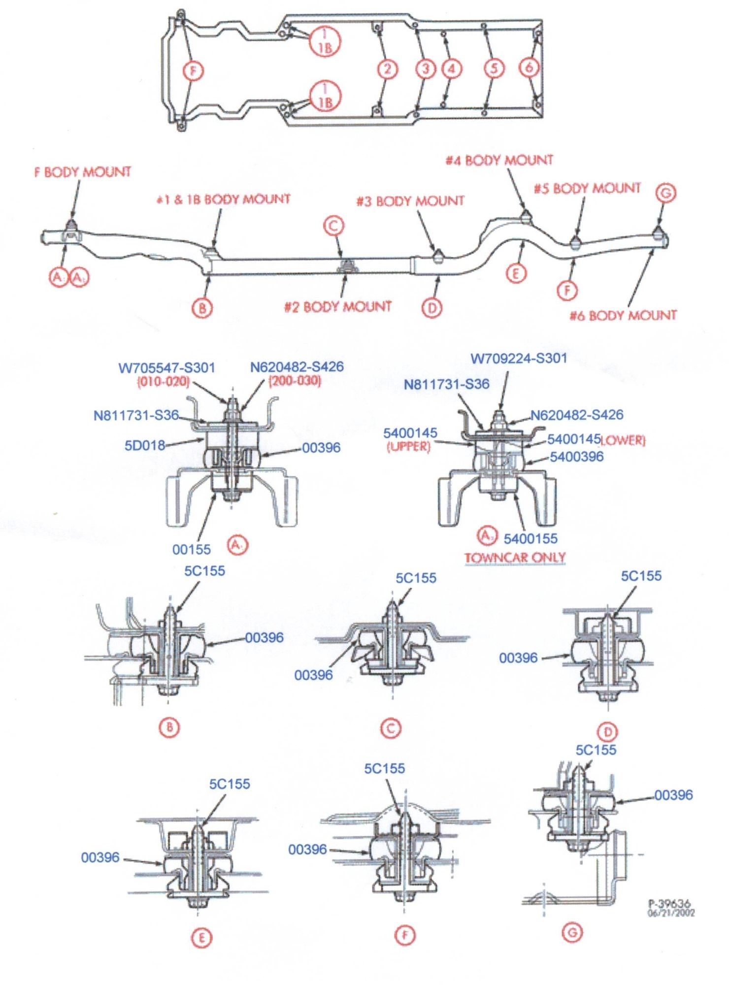

I have Energy mounts in mine right now and find the ride too harsh so want to go back to rubber. I wasn't planning on using Dorman, I want to order everything from Ford, just need to know which mounts go where. When I did Energy mounts I used same ones for all 14 but apparently the OEM ones are different. I can't figure out what the difference is. Is it just the bolt length?
Right now I've determined that 6W1Z-5400396-B are the 2 mounts up front by the rad support.
Does Ford number them front to back such as this?

From what I recall
1 is a two piece design and aren't interchangeable.
2 are slightly taller than 3, 4, 6, 7 but same diameter where they go thru the frame
3, 4, 6, 7 are the same.
5 is bigger diameter and have an indexing tab and are not interchangeable.
So is the numbering in my photo correct as to what bushing goes where?
1 is at the rad support that doesn't interchange with anything and has aluminum spacer.
2 are the ones at the firewall.
3 is in the center of the car.
4 is near rear control arm mounts
5 is over the rear axle.
6 and 7 are at the rear.
I was just going through some of the frame photos that I have and it looks like bushing with the alignment tab goes into 2 positions. One that's over the axle and one right behind it.
Looks like you're correct about the 4 tabbed locations. I don't have the OEM mounts to reference but the 2 tabbed mounts (6) after the axle are same dia and height as 3, 4, and 7.
