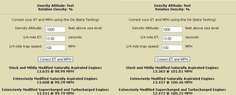

Use this calculator to get a close estimate:
http://www.dragtimes.com/da-density-altitude-calculator.php
Select track and enter the day you went. click get weather data. Then click the most approximate hour in which you made your pass and click on the red lettering highlighting that hour. The data will automatically input to the calculator . Input your et and mph. Then click Calculate DA.
This normalizes everything to a '0' DA condition. This should be done for any and every pass for comparative purposes. It brings you much closer to what is reality rather than just what is mythology. Its not a perfect conversion, as many other factors are at work during a pass, but as far as eliminating weather conditions on the engine it works rather well.
Here is an example:
2 cars each running 13.50 @ 100 mph. Seems like the same ET, same mph right?
Well, car 1 made its pass with a DA of -1000. Car 2 made its pass at a DA of +1000. A difference of 2000 DA.
See the results below to get an idea of what the 'potential' actually is for each vehicle when DA is normalized.
FWIW most anyone looking at this will fall into the first 2 categories. N/A, the first category. Supercharged/Nitrous/Turbocharged, the second. The 'Extensively modified supercharged/turbocharged' category should really only apply to cars making in excess of ~600 whp with an intercooled supercharger or turbocharger.

The largest difference in the above example was only about 3 tenths, so I don't believe a full second is possible.

Density Altitude is a calculation of relative humidity, temperature, and actual altitude. Its not uncommon for me to see -1500 near the end of the season at Atco Raceway, which is somewhere around +150 ft absolute altitude (above sea level). Some of those hot and humid summer days we see +3500 to +4000!
If the guy were to race at Bandimere, CO., say, the middle of summer...and ran 12.3 he very well could see 10s if he were to race at a track that saw '0' DA conditions (such as Atco, NJ). Asuming he factored the lower elevation, and lower DA into his tuning when he raced. Hopefully the electronics would be able to compensate. Otherwise he'd be very lean and might not make it down the track ;)
This is an extreme example and not one you'd likely come across too often. In the Rocky Mountains, cars that run 12s are decently fast.
